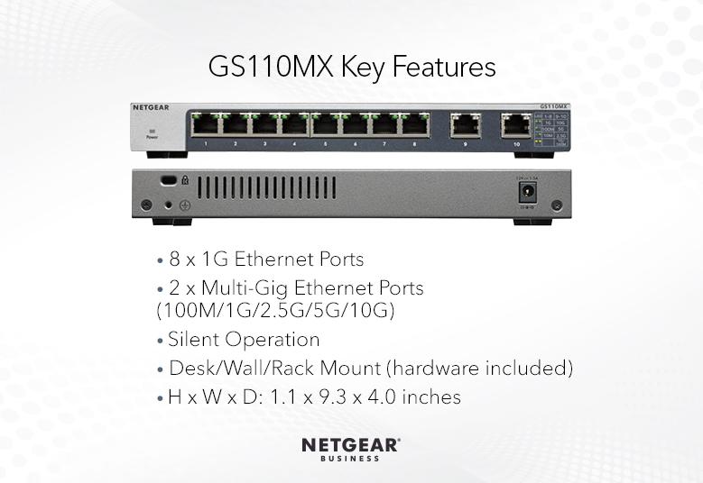

8 x 1G Copper Ethernet plus 2 x 5-speed Copper Ethernet that supports Fast Ethernet, 1-Gigabit, 2.5-Gigabit, 5-Gigabit, and 10-Gigabit connectivity
Gives the exact speed required, no downgrade. Automatically detects which speed is needed by the connected device and provides the adequate speed
Can be connected with regular Cat5E Ethernet cables for speeds up to 5Gb on 5-speed port, therefore reducing wiring costs and hassle to upgrade to Cat6a or better cabling
Plug-and-play, automatic connectivity to your router or modem of 4 or 7 additional wired connections. No need for an IT expert!
Expand your network instantly, and give your devices either 100Mb, 1, 2.5, 5 or 10-Gigabit, automatically
Small and silent desktop, wall mount or rackmount form factor for quiet operation - Adapts to your needs and configuration in any environment

- Dimensions (W x D x H) : 236 x 102 x 27 mm (9.29 x 4.02 x 1.06 in)
- Weight : 0.74 kg (1.63 lbs)
- 100M/1G/2.5G/5G/10G RJ-45 copper ports : 2
- 10M/100M/1G Copper ports : 8
- Form Factor : Desktop/Wall-Mount/Rackmount
- Packet buffer memory : 128KB
- Bandwidth : 56Gbps
- MAC Address database size : 16K
- Number of priority queues : 8
- Jumbo frame support : Up to 9K packet size
- Fan(s) : 0 ( Fanless)
- IEEE 802.3az (Energy Efficient Ethernet) : Yes
- Max power consumption (Watts) : 13.2W
- LEDs : Power, Speed, Link/Activity
- Acoustic noise level @ 25° C (dBA) : 0
- Operating temperature : 0° to 40° C
- Electromagnetic compliance (A or B) : B
