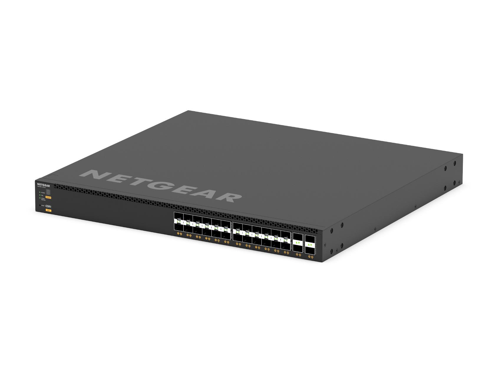

  • 28 Ports
Port Types
  • 24 x 10G SFP+
  • 4 x 25G SFP28
PoE Budget
  • N/A

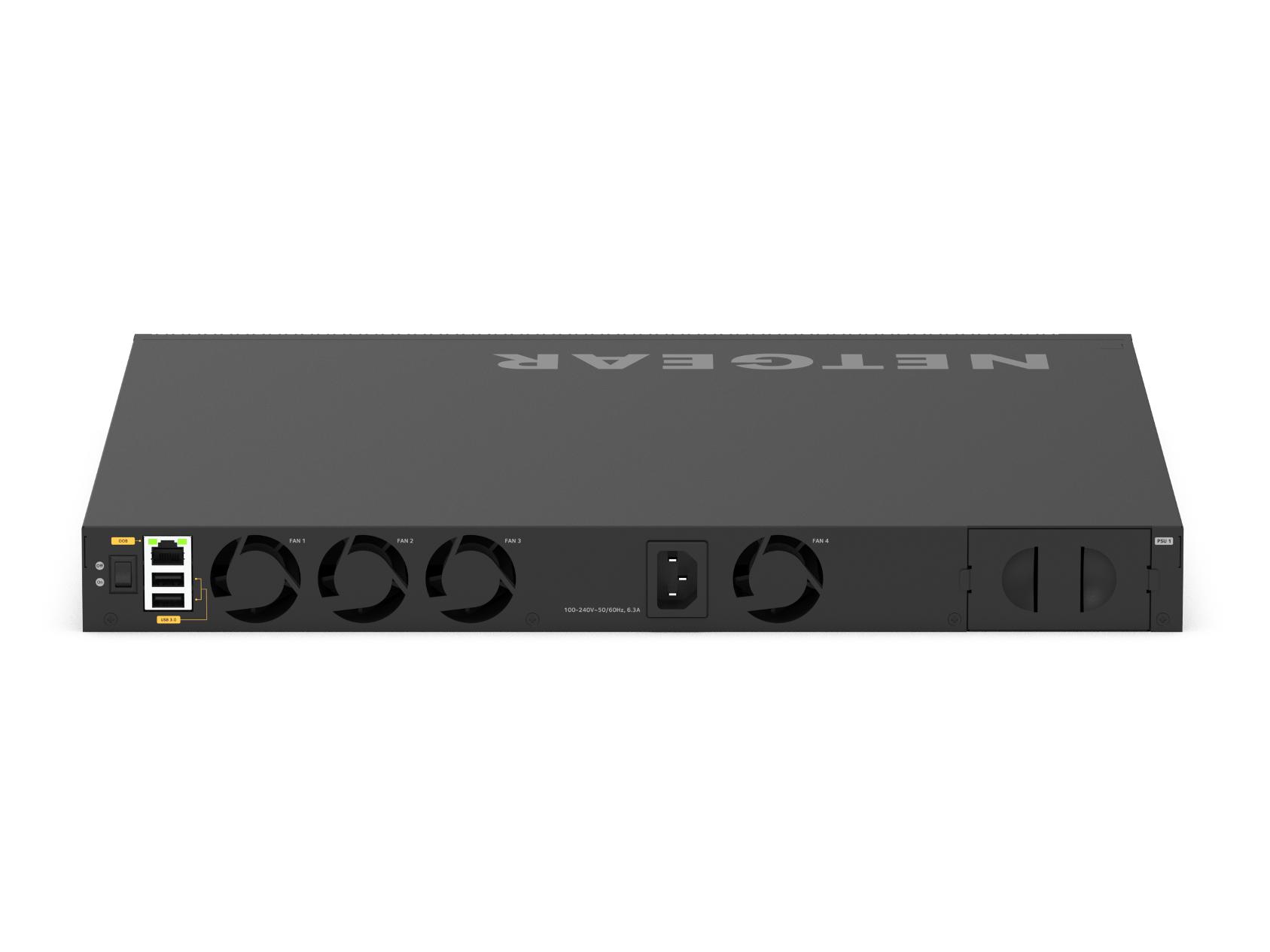

  • 24 10GBASE-X SFP+ ports with 4 25GBASE-X SFP28 uplinks
  • 240W internal power supply
  • 1 slot for modular power supply (1+1 redundancy)
  • Any APS350Wv1, APS600Wv2, APS920Wv1, or APS2000Wv1 can be used

Primary Port Speed
10 Gigabit
Number of Ports
28 (24 x 10G SFP+, 4 x 25G SFP28)

Acoustics
Quiet Mode 34.2dB@25ºC
Power Consumption
119.3W/374.6Btu/hr
Standby without any port connection: 45.2W/141.93Btu/hr
PSU Compatible Models
APS350Wv1
APS600Wv2
APS920Wv1
APS2000Wv1
