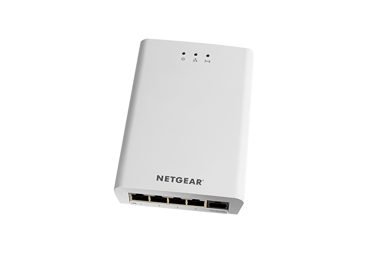

Features and benefits
Small form factor and inconspicuous appearance
The aesthetically pleasing design of the WN370 allows the access point to blend nicely in the hotel room and school dormitories. WN370 provides wired access directly to the users, where the traditional form factor Access Points are normally installed on the ceiling, away from the access of the users that need wired connectivity. The WN370 is installed with easy attachment to the junction box and appears with a nice decorative appearance.

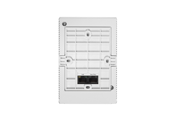

Fast installation and PoE powered
The WN370 can be installed easily and less than 5 minutes. The WN370 ships with mounting brackets and fits into both US and EU standard electric junction boxes. Only 4 screws are needed to reliably install the WN370 to the wall with low protrusion. The WN370 is powered via Power over Ethernet on the 1 Gbps uplink. Simply connect a Ethernet cable between the WN370 and a PoE enabled switch and the WN370 is up and running. There is no separate power cord needed.
Flexible and easy deployment
WN370 can be installed easily and does not need sophisticated skills of engineers. WN370s are generally deployed in room, especially effective in areas where deploying the access points in traditional locations (such as ceiling mounted or hallways of dormitories and hotels) are not feasible. Because the WN370 is designed to provide coverage in a specific room, where the RF containment is more well defined, no extensive site survey is required. Finally, because the WN370 comes with four Ethernet ports, users can plug in multiple wired devices without the requirement to pull additional cables from the access point to the wiring closet, thereby saving both time and money to meet the requirements of multiple Ethernet ports per room
Centrally managed with complete enterprise features
The WN370 is centrally managed by Wireless Controllers. All of the configurations can be centrally configured and stored at the wireless controller. Once the WN370 is discovered by the wireless controller, it will receive the latest firmware and the updated configuration provided by the wireless controller. The wireless controller will automatically and dynamically adjust the RF frequency and the output power of the WN370 to ensure optimal frequency reuse and the best power setting to provide ubiquitous coverage of the intended location. Comprehensive site survey is generally not needed, thereby making the installation and wireless design of WN370 as simple as it gets.
Includes Guest Facebook WiFi check-in
Easy guest check-in to your business Gain insight on your clients and business Get more attention to your business Instant set-up
