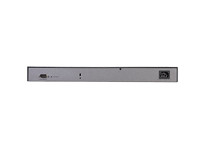

  • Electrical Specifications : 100-240V, AC/50-60Hz, Universal Input, DC 5V/8A (internal power supply)
  • Dimensions (W x H x D) cm : 26.1 x 4.3 x 44
  • Dimensions (W x H x D) in : 10.3 x 1.7 x 17.3
  • Weight kb/lb : 2.912/6.4

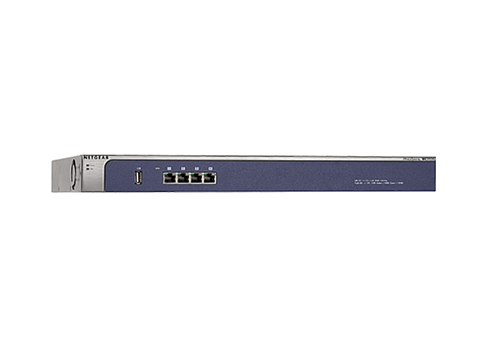

  • HARDWARE :
  • Gigabit RJ45 Ports LAN : Switch 4-port 10/100/1000
  • Flash Memory/RAM : 8 MB + 2 GB CF/1 GB DDR2
  • USB Port : 1 port for USB storage
