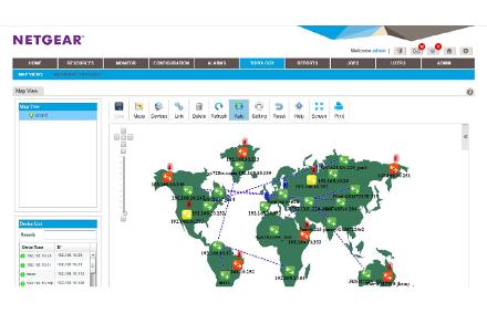

Topology Mapping :
Topology views displaying discovered and manually created links, including filtering
Topological Management Alerts :
For discovered and manually added links in Topological View, different color and flashing styles are used when:
