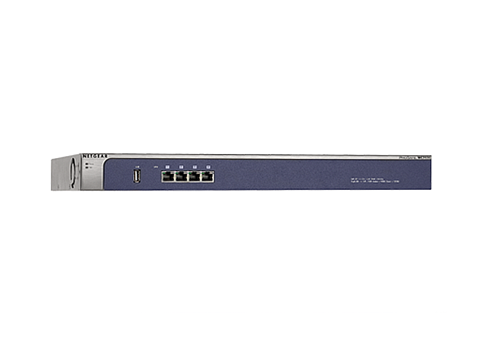

WC7520_tech_specs_image_1

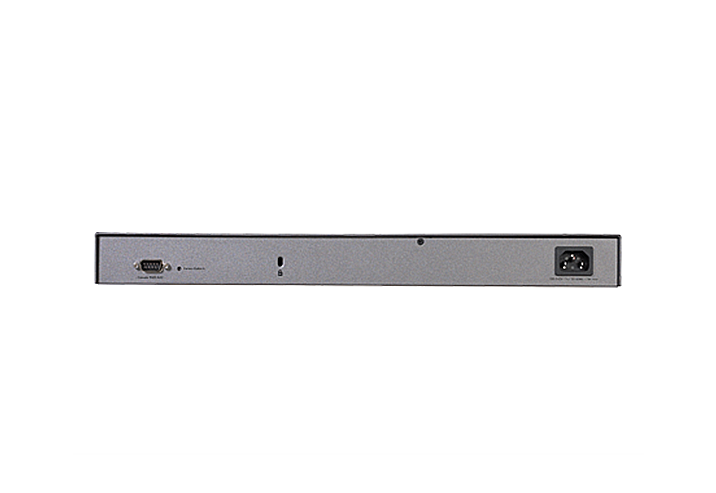

WC7520_tech_specs_image_2
