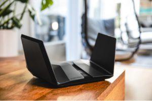

The latest addition to the NETGEAR Nighthawk routers, the Nighthawk AX8 8-Stream WiFi Router and the Nighthawk AX12 12-Stream WiFi Router, support higher number of WiFi streams than ever before. As these next-generation WiFi 6 routers add more spatial streams and QAM to vastly increase overall network capacity and efficiency, the new standard of WiFi is ready to deliver significant improvements over the earlier generations.
