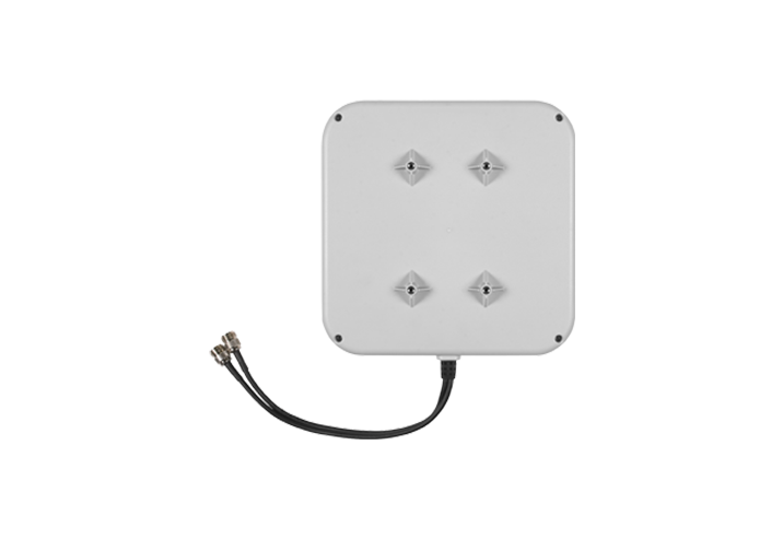

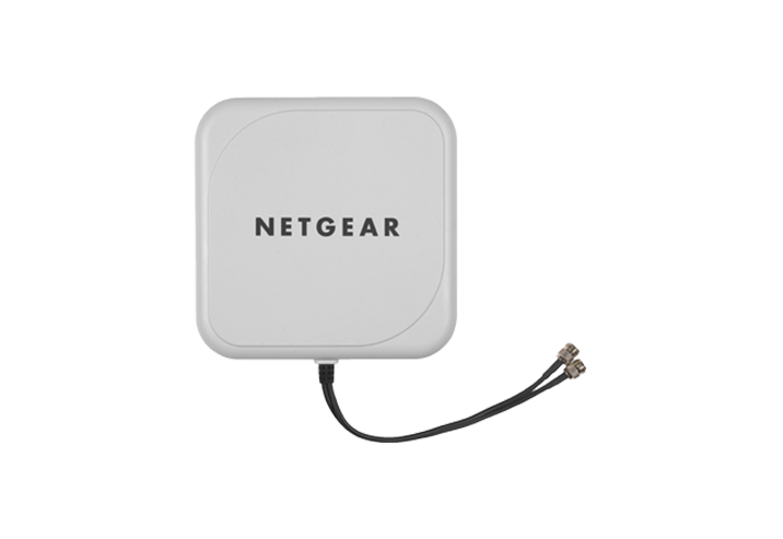

Optimize WLAN Range and Power with the 10 dBi 2x2 Indoor/Outdoor Directional Antenna
The ANT224D10 2.4 GHz antenna provides extended range connectivity for point-topoint wireless bridges at wireless 802.11n speeds. With a maximum range of 8.5 KM, the ANT224D10 enables high speed connections for building-to-building deployments. Additionally, this antenna can be used indoors for floor-to-floor connectivity or to provide a narrow beam of coverage. Due to the multiple streams of traffic in the 802.11n specification, this antenna requires two antenna cables, which are available in a variety of lengths. It includes several mounting options and comes with wall/pole mounting hardware. Cables are sold separately.
NETGEAR line of antennas and accessories for 802.11b, 802.11g and 802.11n devices give you multiple options for maximizing the reach and performance of your wireless infrastructure devices. Every WLAN deployment is unique. With both directional and omni-directional antennas, indoor and outdoor options, low-loss cables, mounting hardware, and other accessories, installers can customize a wireless solution that meets the requirements of even the most challenging applications.

  • Dimensions : 240 x 240 x 40 mm (9.45 x 9.45 x 1.57 in)
  • Weight : 0.7 kg (1.54 lb)
  • Wireless Signal : IEEE 802.11g
  • Typical Application : Indoor/outdoor
  • Maximum Outdoor Range* : 8.5 km (5.28 miles)
  • Frequency Range : 2400 – 2500 MHz
  • Gain** : 10 dBi
  • Beam Width : Horizontal 33° Vertical 32°
  • Polarization : Linear; Vertical
  • Operating Temperature : -30º to 80º C (-22º to 176º F)
  • Connectors : Antenna - N Jack Male
  • Lightening Arrestor - N Jack Male to N Jack Male
  • Extended Cable - N Plug Female
  • Ordering Information (all regions) : ANT224D10-10000S
    • Warranty: This product is backed by a NETGEAR limited 1-year Hardware Warranty .
  • Support : ProSupport Lifetime 24x7 Advanced Technical Support. (Remote diagnostics performed by our technical experts for prompt resolution of technical issues).
  • *Range estimation is based on FCC-compliant operation of two (2) 802.11 APs each with two (2) ANT24D18 antennas placed at 90 degree rotation, 5 m antenna cables, and lightning arrestors installed. With the antennas positioned 36 m above the ground, data rate should sustain 1 Mbps under ideal line-of-sight conditions.
  • **Gain: A ratio of decibels to an isotropic antenna that is commonly used to measure antenna coverage.
  • NETGEAR Indoor/Outdoor 10 dB 2x2 Directional Antenna ANT224D10
  • 2 lightning arrestors with 30 cm low-loss cables
  • 2 reverse N/SMA adapter
  • Wall mount and pole mounting hardware
  • Installation Guide and Warranty/ Support card
