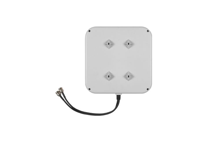

Optimize WLAN Range and Power with the 10 dBi 2x2 Indoor/Outdoor Directional Antenna
The ANT224D10 2.4 GHz antenna provides extended range connectivity for point-topoint wireless bridges at wireless 802.11n speeds. With a maximum range of 8.5 KM, the ANT224D10 enables high speed connections for building-to-building deployments. Additionally, this antenna can be used indoors for floor-to-floor connectivity or to provide a narrow beam of coverage. Due to the multiple streams of traffic in the 802.11n specification, this antenna requires two antenna cables, which are available in a variety of lengths. It includes several mounting options and comes with wall/pole mounting hardware. Cables are sold separately.

Physical Specification
  • Dimensions : 240 x 240 x 40 mm (9.45 x 9.45 x 1.57 in)
  • Weight : 0.7 kg (1.54 lb)
What's in the box
  • NETGEAR Indoor/Outdoor 10 dB 2x2 Directional Antenna ANT224D10
  • 2 lightning arrestors with 30 cm low-loss cables
  • 2 reverse N/SMA adapter
  • Wall mount and pole mounting hardware
  • Installation Guide and Warranty/ Support card
Technical Specs
  • Wireless Signal : IEEE 802.11g
  • Typical Application : Indoor/outdoor
  • Maximum Outdoor Range* : 8.5 km (5.28 miles)
  • Frequency Range : 2400 – 2500 MHz
  • Gain** : 10 dBi
  • Beam Width : Horizontal 33° Vertical 32°
  • Polarization : Linear; Vertical
  • Operating Temperature : -30º to 80º C (-22º to 176º F)
  • Connectors : Antenna - N Jack Male
  • Lightening Arrestor - N Jack Male to N Jack Male
  • Extended Cable - N Plug Female
  • Ordering Information (all regions) : ANT224D10-10000S
