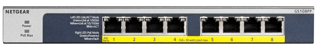

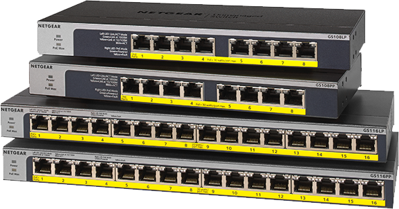

Industry first: NETGEAR FlexPoE, available on select NETGEAR PoE switches, allow you to upgrade your switch PoE budget with new power adapters without replacing the entire switch.
The real benefit for the customer is that if you’re not sure how much PoE power you’ll need and have a limited budget, you can purchase the lower-powered version of the switch, and then, as your PoE needs grow, you can later upgrade the power adapter to get more PoE budget, as opposed to traditional switches, where you would need to completely replace the entire switch to get more power, costing you more in the end. NETGEAR FlexPoE is available on the following models: GS108LP, GS108PP, GS116LP, GS116PP, GC108P, GS110TPP
